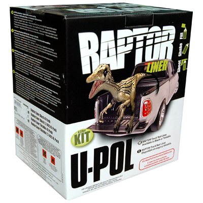

u-pol raptor
[Linked Image von autowares.com]
its very good. my iveco -
[Linked Image von i37.tinypic.com]
[Linked Image von oi40.tinypic.com]
[Linked Image von oi43.tinypic.com]
nothing will scratch it. I will spray the bremach in white u-pol. good for forest.

Hi Redd!
I know that, it is also Polyurethan, very resistant … even to a hammer or a knife - we've made some tests smile One of my friends has the hole car in it (hot spraying), but there is the same problem as Ozymandias has written before. You can't repair or polish the surface, as same as by matt coating.
In white you will need a strong Kärcher wink
But it looks great and it is veeery heavy-duty smile
